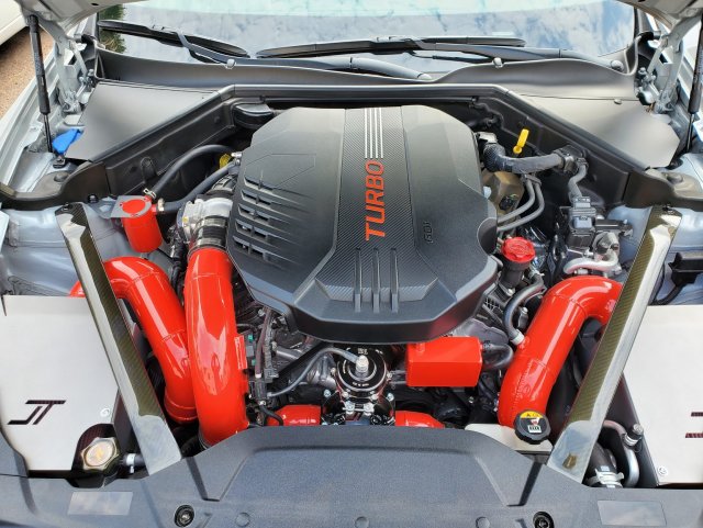

Just had my OCC powder coated, the PCV side is a new Mishimoto, waiting on the bracket to get finished & the other one is a Tork Motorsports.
1,721
594
Here's my newly powder coated Oil Catch Cans installed, what you all think...

It looks like you have a red theme going?
1,721
594
I wanted to bring the outer look into the engine bay so my wheel & caliper color. I don't know what I'm going to do with the engine cover yet, any idea's @CKeeler.
