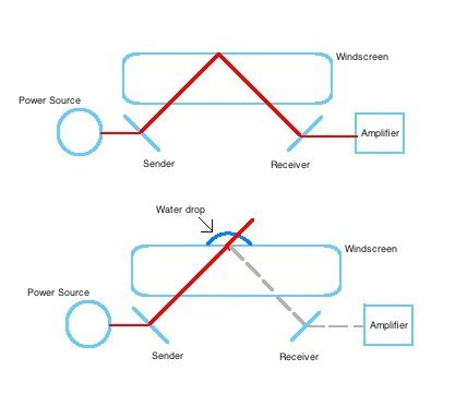

It uses an LED light shined at an angle towards the windshield glass. There is an emitter and a receiver.
When water is on the outside of the glass, the light refracts differently and the light receiver knows there is water on the sensing area.
It's pretty simple actually. Uses infra-red light so you can't see it with your eyes.
The sensing area is small, near the rear view center mirror. windshield_wipers_rain_sensing.jpg Venkataraju-Rain_Sensor_Pic.jpg automotive-electronics-in-automobile-electronic-control-unit-25-638.jpg

DJL. Thanks for that useful info. That sets me for an experiment. If I apply car polish or Rainex to that area of the windscreen it might prevent beads of water ... and that might slow the wiper frequency down. I'll give it a try.
275
72
2018 Kia Stinger Limited
Rain -X or similar product definitely reduce the performance of the rain sensing.
I use rain -X on my windshield (not just the sensing area) . Fresh application applied today as the weather was nice where I live (+10 C)
