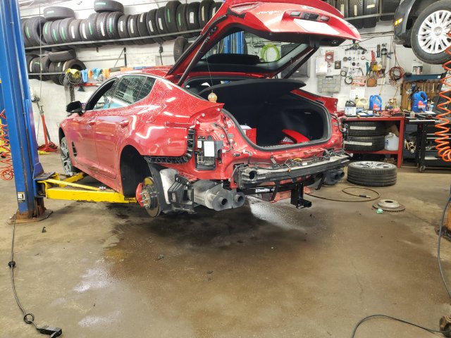

How can I get my hands on the OEM Kia stinger trailer hitch?
Sent from my SM-G965W using Tapatalk
#2228
275
71
2018 Kia Stinger Limited
Who's hitch did you go with and how was the install?
Draw-Tite 24974 is the only hitch on the market as far as I could find.
Install is super easy if you are comfortable taking off the bumper cover.
I cut the bumper cover with a hot-knife. Worked like a champ.

Did you install a brake controller?
LOL
No. This type of trailer doesn't have brakes to control. No hobby trailer of this size has brakes
My trailer and bike weight a combined weight of less than 4 average sized adult males..
I towed the exact same bike and trailer for years with my much smaller and lighter Mazda 3. All is good
