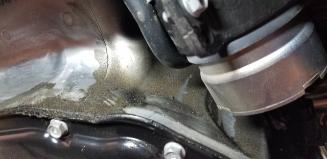

That was in early 2019. I have been since been back to the dealer for the second oil change and they said nothing so i figured I was all good. Now at 15k miles I dropped the under body panel to do my own oil change and what do I see? Oil on the lower pan and the area above the pan, the subframe cross member, also on the underbody panel. So I pull the dipstick and the oil looks to be a half to a quart OVERFILLED! I am concerned there is water in the oil. The radiator shows full but the overflow tank is empty and has been slowly losing level since the car was new. I am taking it in to the dealer Monday as I called the service manager as soon as I discovered the leaks again. He knew who I was as I am the only Stinger owner with any oil leaks.
I am wondering if I should drain some of the oil before taking it in to see if there is water in it? or trust the dealer to eval the problem correctly and come clean with me.

I say let them deal with it. It’s their job to maintain proper working order of the cars

I did drain about a quart from the bottom of the sump and it looks like it's just oil, no coolant or other fluid. The dipstick still shows waaay overfilled. I'll need to take that up with service when I see them because they are the only ones to service the vehicle. I haven't started to look into why the coolant overflow bottle is empty. I am trying to look for a spec for the coolant the factory puts in the stinger. It almost looks like Zerex g48 as it is light green or turquoise in color. I wish Kia had a spec page like Benz and BMW to specify fluid specs.

Update: The overfilled oil is due to gas being forced into the crankcase by a defective high pressure fuel pump. I guess my intuition that something was getting into the oil was correct, it just wasn't coolant. Dealer is replacing the high pressure fuel pump and they are replacing some o-rings and gaskets to repair the oil pan leak. I will speculate that the pan leak is due to the gas in the oil getting past the gaskets. I wonder how many lifetime miles I have lost on the engine with contaminated oil being pumped around as lubricant. I'd like to know why, if the fuel pump pressure was forcing gas through the piston rings or into the lubrication side of the system through something, why an O2 sensor or something didn't sense too rich a mixture and throw a code? Sounds like a pretty major malfunction to not throw something out of whack.
Low coolant in the overflow bottle is still a mystery but they did test it and the system cycles the way it should.
One month and 500 miles later: 500 miles later and the oil is again 'overfilled' with gas in the oil sump. So the HP fuel pump is not the failure. Car is back at the dealer for another two weeks so far with no resolution or solution path for the issue in sight. i am waiting for Kia engineering to 'get involved". They are now after two weeks in the shop, asking the dealer to remove the ADD catch can as a potential problem. I guess I have been 'stung' by the Stinger as neither the dealer nor Kia seems to want to admit there is a major issue with this vehicle. i have already explained to the service manager that I am getting close to the end of my patience as Kia and the dealer needs to step up and do the right thing to get this resolved and make me whole again.
